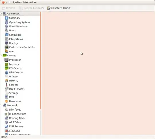

  1. Hardinfo
    Search for the hardinfo package in the Software Center or run sudo apt-get install hardinfo from the command line. The motherboard make and model can be found on the Devices > DMI page.
    Hardinfo image

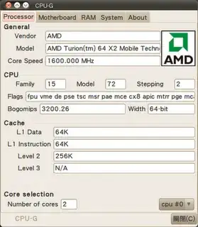

  2. CPU-G - Linux alternative to the popular Windows application CPU-Z. Originally created by ftsamis, it has since been picked up by Atareao Team
    sudo add-apt-repository ppa:atareao/atareao
    sudo apt update
    sudo apt install cpu-g
    CPU-G image

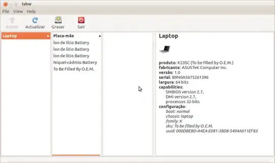

  3. lshw-gtk – Graphical frontend for lshw command
    lshw-gtk image

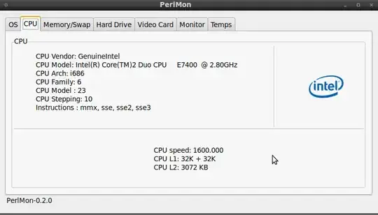

  4. PerlMon
    Perlmon image
