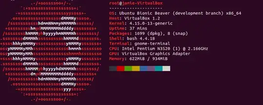

You can also use neofetch. First install it:
sudo apt update
sudo apt install neofetch
To use it type
neofetch
and you will get something like this: enter image description here
