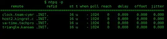

Checking if it synchs
sudo ntpq -c lpeer
This will show a list of all the servers and when they where last checked. Random example from the web:
