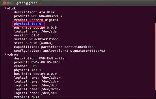

  • Run sudo lshw -C disk and find out the Physical id of the hard disk which has Windows installed.
lshw -C disk
  • Open grub.cfg in a text editor with root permissions (example, sudo gedit grub.cfg).
  • Add the following entry in the file:
    menuentry "Windows 7" {
        set root=(hdX,msdosY)
        chainloader +1
    Here, X is the physical id of the hard drive, and Y is the partition number where Windows is installed.
Restart and test.
