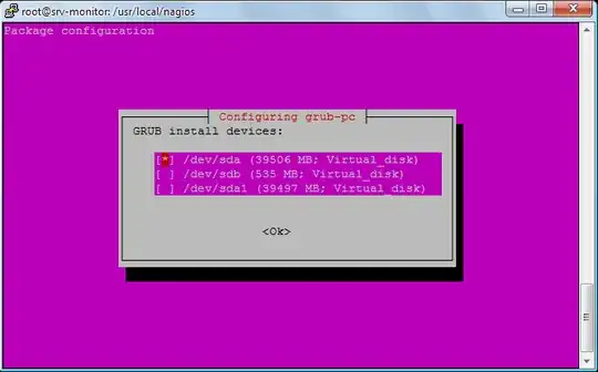

Finally, once inside Ubuntu, you'll need to perform one last step, to prevent Ubuntu system updates from reinstalling Grub to your internal hard drive and replacing the Windows bootloader.
Open the Terminal application and run the following command:
sudo dpkg-reconfigure grub-pc
Enter your Ubuntu user's password, and then press Enter.
Press Enter for the first two screens. The third one is the one we're interested in.
Press Tab and then Enter, then navigate to your external hard drive using the arrow keys, and finally select using by hitting Space.
Hard drive selection
Note: Hard drives look like /dev/sda in this list. Any entries with numbers, like /dev/sda1, represent partitions and should be ignored.
Finally, confirm your selection by hitting Enter.
Your computer should, as of now, behave correctly and your start-up problems should be history.
