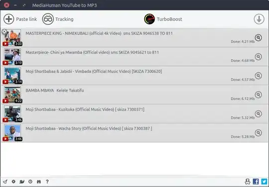

For those of us who prefer a GUI interface, there is YouTube to MP3 from MediaHuman.
1. Installation
You can do direct downloads for Ubuntu 16.04+ but I prefer the repository because of automatic updates.
sudo apt-key adv --keyserver keyserver.ubuntu.com --recv-keys 7D19F1F3
sudo add-apt-repository https://www.mediahuman.com/packages/ubuntu
sudo apt update
sudo apt install youtube-to-mp3
2. Usage
Search and open 'Youtube to MP3' via dash or another launcher. Copy the Youtube video URL from the browser to your clipboard and paste it into the application by clicking the 'Paste link' button on the top-left corner. See screenshot below.
The download and conversion will begin automatically and the audio saved in the Home folder under /Music/Downloaded by MediaHuman
Youtube to MP3 main interface

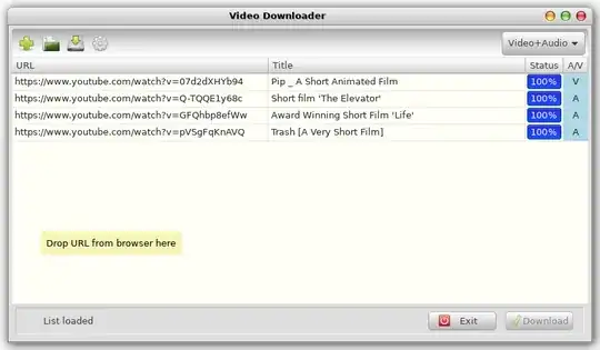

In case you need a GUI for downloading Audios from Youtube only I'd like to introduce YoutubeDownloader
It has been written to ensure the best possible quality in combination. It provides a simple interface for downloading videos or audio tracks only. It has a GTK3 interface and was written for Linux/Ubuntu
