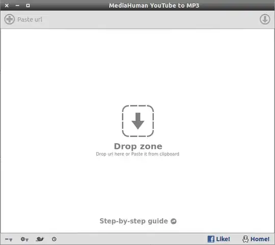

You can install Youtube to MP3 from the software center. I use it and it's awesome, check out the reviews too.
https://apps.ubuntu.com/cat/applications/saucy/youtube-to-mp3/
Easy-to-use software to download YouTube and Vimeo videos as MP3.
