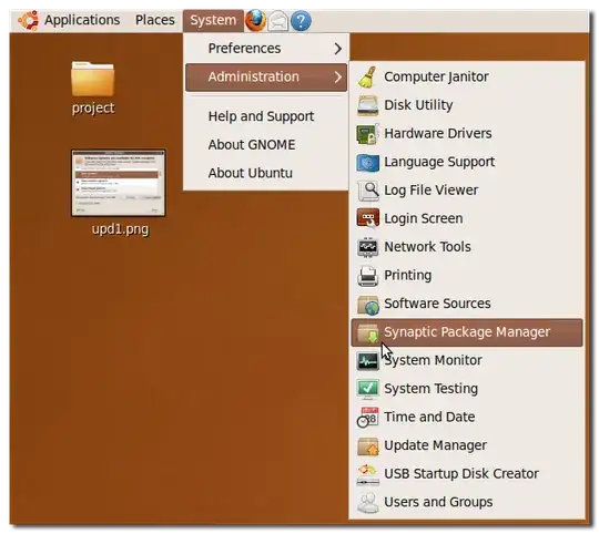

To pin your kernel packages, first you must determine what version your kernel is. One way to do this is to open the Synaptic Package Manager in System > Administration.

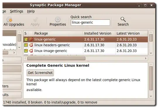

Type in “linux-generic” in the Quick search text field and hit enter.
Make a note of the number listed in the “Installed Version” column. We’ll use it in the next step.

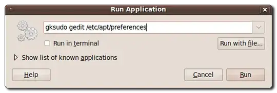

Next, we need to edit the file /etc/apt/preferences. Open it by pressing Alt+F2 to bring up the Run Application window and entering in:
gksudo gedit /etc/apt/preferences

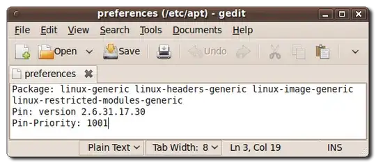

This will open up a gedit window. Most likely the window will be blank, unless you’ve played around with APT before.
In the window, type in the following, replacing the version number with the version number you found in the Synaptic Package Manager.
Package: linux-generic linux-headers-generic linux-image-generic linux-restricted-modules-generic
Pin: version <insert version here>
Pin-Priority: 1001

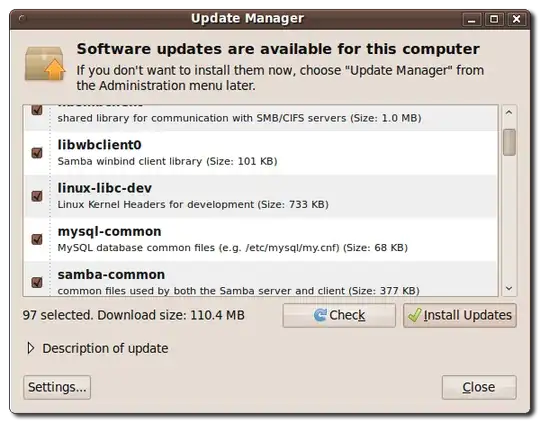

Save the file and close gedit. If you open the Update Manager, you should see that the Linux kernel updates are now hidden!
