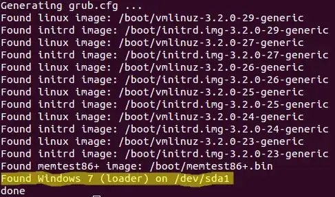

That should do it. When you run that last command, make sure to see Windows. Take a look at this example. See Windows at the bottom:
Example of what sudo update-grub renders
If you do not see Windows, then you might have installed your dual boot wrong.
Tell me if it works. Hope this helps you.
