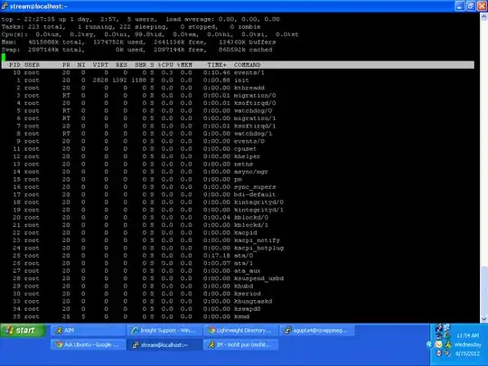

I've been learning about the top command. There are some terms on which I am confused. I need some clarification.
screenshot with top
What are the WA, HI, SI and ST terms in the CPU(s) row, and also VIRT, RES and SHR?
