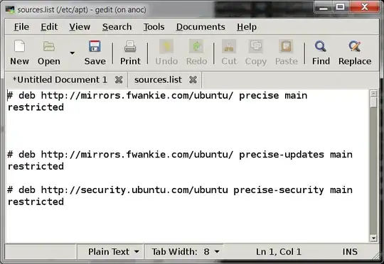

I am trying to run gedit from an SSH terminal on Windows, connected to an Amazon EC2 instance running Ubuntu 12.04 Server and I am getting this error:
Cannot open display:
How do I fix it?

So you are connecting from your home pc (let's call it your machine) to a server (let's call it server) via ssh? You want to start a program with a graphical window on the server via your machine? If that is correct than by all means read on.
Let's call the program to start gedit but the process is the same for all. Depending on where you want to see the graphical window skip to the right heading.
Window on your machine's screen
If you want to see and use gedit's window on your remote machine but start in on the server, you will want your shell session to look like this:
user@remote-machine:~$ ssh -X user@server

Don't mind the warnings, they are normal - the gedit window will pop up on your remote machine's screen like it would look on the server. The trick is to use the "-X"-option as in ssh -X which enables X-tunnelling and sets the DISPLAY variable right.
This assumes that you're using an SSH client that supports X11 and that your server has an X-server running (some without a need for GUIs don't run an X-server). Especially on windows this might be an issue as most windows terminal programs don't have X. As izx stated the MobaXTerm is one of the many SSH clients for windows that has an X-Server though.

Since you are using Windows on your side, you will need an SSH-client that runs a local X server on Windows to run graphical applications from the server remotely on your screen.
From experience, I would recommend the free MobaXTerm which has this functionality built-in. Please download it and give it a try:
If you get any errors, that's because sometimes a minimal server image may not be set up to allow X-forwarding into it. In that case, please comment and I'll help you solve it; I've done this with lots of minimal VPSs running Ubuntu/Debian.
