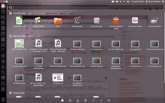

Browser history for instance will often tell you what time websites were accessed. Also gnome's recently accessed files will show opened files. You can get to this by going to Unity's Dash Menu and click expand on the recently used files section:
recently used files in unity
