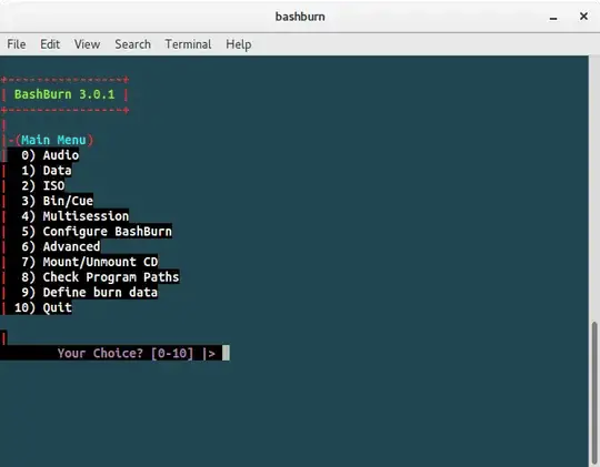

10
bashburn is your friend.
sudo apt-add-repository universe
sudo apt-get update
sudo apt-get install bashburn
Currently BashBurn can:
  • Burn data CDs/DVDs (Including CDRWs)
  • Burn music CDs
  • Burn CD/DVD-images
  • Rip data/music CDs
  • Manipulate ISO-files
  • and probably more…
Source
