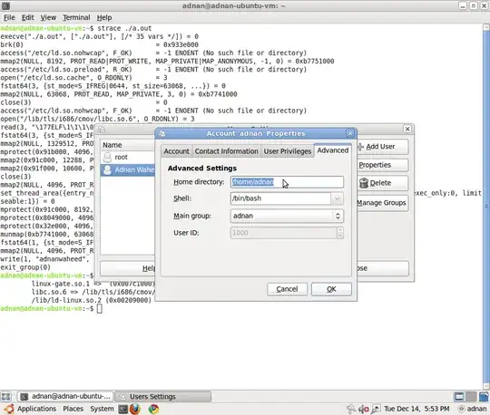

Copy your home directory to other partition and then use System->Administration->Users & Groups to open user settings dialog. Click on the keys icon to authenticate your self
alt text
After that select the user that you want to change and click properties, go to advanced tab
alt text
change the home directory to new directory i.e the directory that you copied to other partition.
