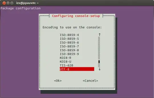

  1. Choose the default UTF-8, and press Tab to go highlight OK and then press Enter to go to the next step. (You can press it again and highlight Cancel to go back.)

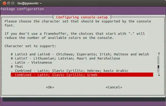

  2. Choose the default Combined - Latin, ... option ("Latin" includes the English alphabet) and proceed to step 3:

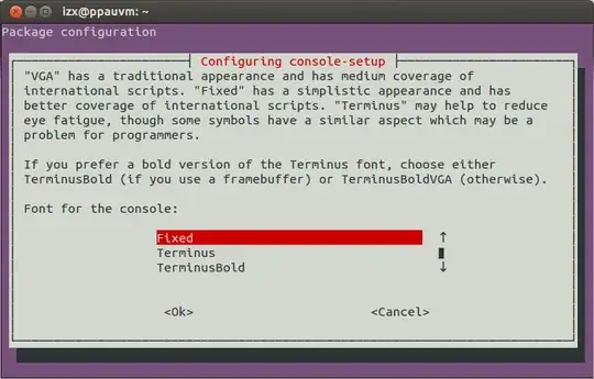

  3. Select the font - be sure to read the notes above on the visual effect different fonts can have:

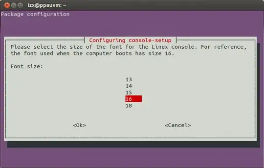

  4. Select the font size:
