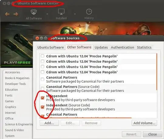

Apparently the ppa got added, when you installed the game and now the ppa is broken or suspended. At least that's my best guess. It should be save do remove those repositories from your list. To do so got to:
Remove sources
Software Center -> Edit menu -> Software Sources -> Click the tab Other Sources -> Unselect the ppas in question.

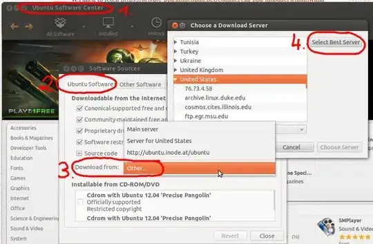

If that doesn't work try to change the download server to the best one:
Select best server
First three steps from above -> Download from -> Other -> Select Best Server
