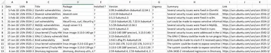

Here is some node code (tested with node 6.10.0) that will scrape the contents of https://usn.ubuntu.com/usn/ into a spreadsheet.
Here is what the spreadsheet will look like:
Here is the way to run the code:
