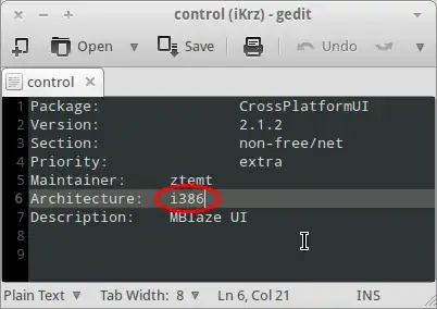

  4. Open extracted directory->DEBIAN and open control file in a text editor.
  5. Now replace the Architecture from i386 to all.enter image description here
  6. Save the file and close it.

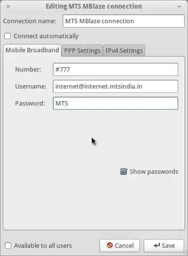

  9. Open Edit Connections->Mobile Broadband (Tab)->Select MTS MBlaze Connection and click on Edit.
  10. Under Mobile Broadband, type internet@internet.mtsindia.in as username and MTS as password.
  11. Check Available to all users and Connect automatically if you want.
  12. Save it and close Network Connections.

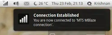

  14. After the modem get recognised by the system, try to connect Internet.
  15. If everything goes right, you will see that your Internet connection will get connected.enter image description here
