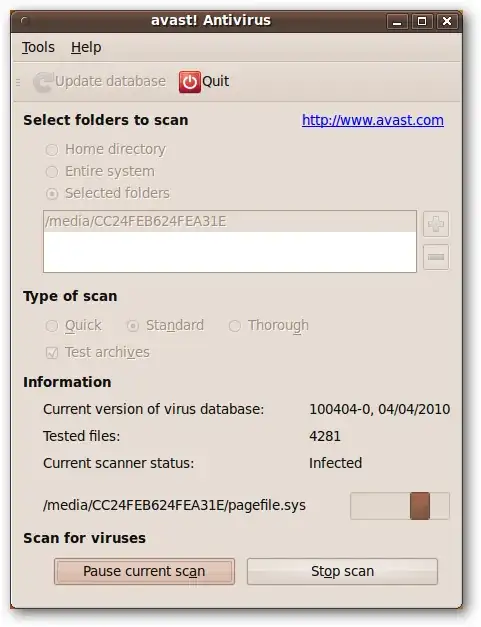

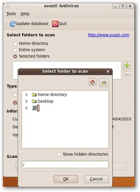

14
It is possible to scan your windows partition. I recommend you do it off a live CD (32 bit).
Download and install Avast! Linux Home Edition.
Launch Avast and update its Database.
Now mount your Windows Partition.
Click on Selected folders and browse to your partition.
Click start scan.
