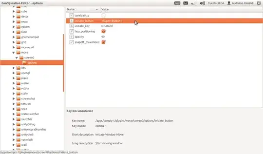

Here's the way to do it without messing with the keyboard layout.
Note: You must know that this is a compiz feature, I recommend you not to change the keyboard layout settings.
  1. Make sure you have gconf-editor. Also known as Configuration Editor. You can install it from the Software Center.
  2. Run it and browse to /apps/compiz-1/plugins/move/screen0/options/.
  3. Simply change initiate_button from <Alt>Button1 to <Super>Button1.
  4. And you're done.
How-to
NB: Maybe if you want the easier way to do it, mess with CCSM (compizconfig-settings-manager).

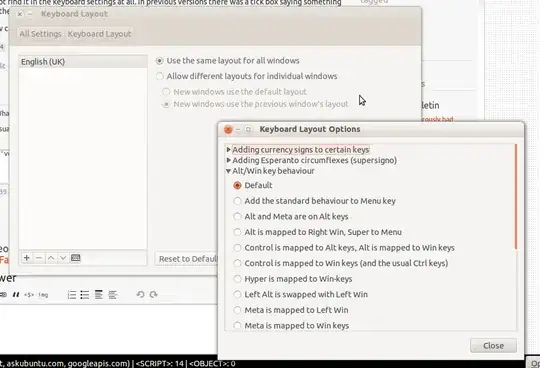

Search keyboard layout, it's a tab in keyboard settings too. Press options and check out the screenshot, hope that helps.
