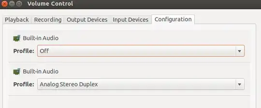

A simple configuration setting helped me so far (half a year) on Ubuntu LTS 12.04. In pavucontrol in the last tab "configuration", I have two "Built-in Audio" section where I can choose a profile. The first one had "Digital Stereo (HDMI) Output" as profile. I changed this to "Off" and I had the above described problem not anymore. Here is a screenshot:
