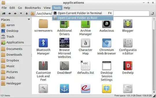

In the file manager, go to /usr/share/applications. Open it with root access (Tools -> Open Current Folder as Root)
Open as root

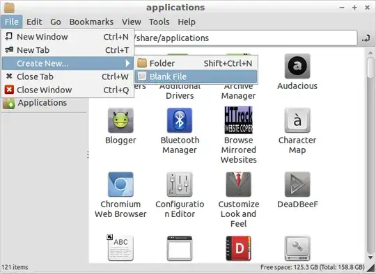

In your root access file manager window, create a new file (File -> Create New -> Blank File)
blank file

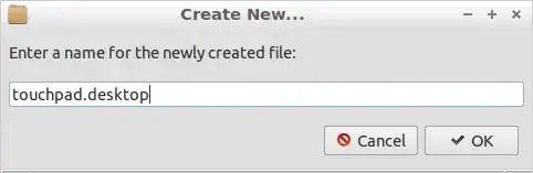

Name the new file touchpad.desktop.
file name

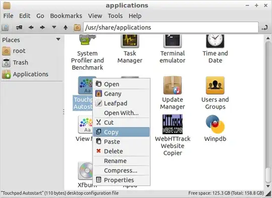

Again, find your file in the root access file manager window. Right-click and copy.
Copy

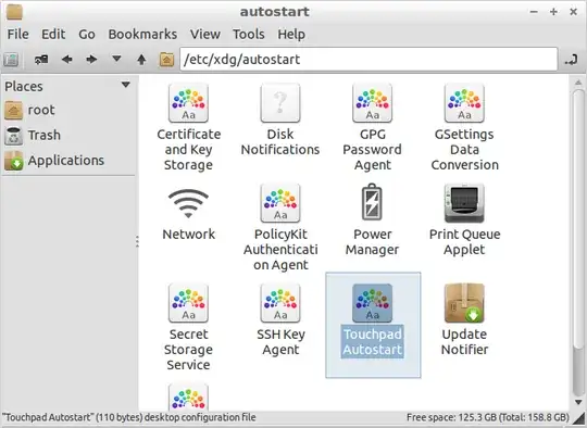

Now navigate your root window to the autostart folder:
/etc/xdg/autostart/

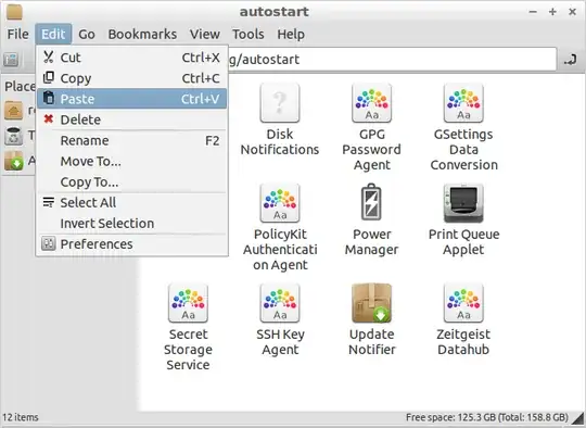

Finally, paste in your desktop file you created earlier.
Autostart File
If you did everything correctly, you should see a lot of other autostart files, but you will also see the file, "Touchpad Autostart"
It's there...
