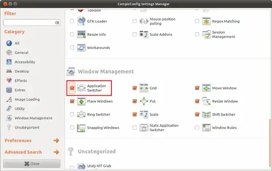

You'll get this window
Scroll down and select the checkmark on the left of "Application Switcher":
