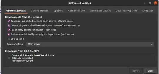

Go to Ubuntu Software in Software & Updates and try changing the Download from: to Main Server
