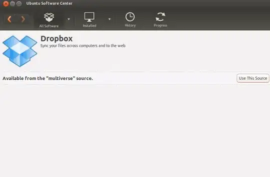

I have Ubuntu 12.10 installed, since about 1 month ago i can't install any program from software center, or synaptic or terminal, and also i can not update my installed software. Here is a screenshot from Software center:
You see there is neither info of the program nor the install bottom. (in "Software Source", multiverse source is checked)

It seems that you've set a proxy server "127.0.0.1:9050"; maybe some anti-filtering programs or something like that. so if you don't persist on using this proxy, open network and set proxy to none (or any other proxies you need) and click on set system wide. then you should have the ability to use sudo apt-get update to update the list of packages and then install them via sudo apt-get install or using synaptic or software-center.
If you persist on using proxy server, first check if you can access internet with that proxy (using firefox or any other browser with that proxy and opening a website). then set the proxy in network and set system wide. remember that if your proxy needs authentication, you must edit the /etc/apt/apt.conf file by hand to something similar to
Acquire::http::proxy "http://username:password@proxy:port";
Acquire::https::proxy "https://username:password@proxy:port";
Acquire::ftp::proxy "ftp://username:password@proxy:port";
