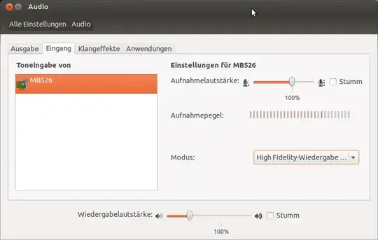

Is there a way to use the notebook as speaker for my smartphone? I linked them via Bluetooth and saw that the smartphone can be used as an input-Device for music and sound.
You can see it here: enter image description here
My smartphone says that the laptop is linked as an Audio-System. If i play some music on the smartphone, it is recognized by the audio manager. You can see it in the picture, the bar is active and keep moving to the music. But i can't hear anything. How can i get this working?

You could do this:
 sudo apt-get install blueman
and then this:
 Bluetooth -v -l device
and it might work fine this way.

Yes, you can. Install the blueman package and launch Blueman. Now, look for "Advanced Audio Receiver - Experimental Headset Emulation - Very Experimental" in te settings and tick the box. If everything is set up correctly, you can now use your computer as an A2DP sink.
