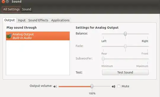

Even Now My system sound OUTPUT connector option is gone here is the screen shot enter image description here

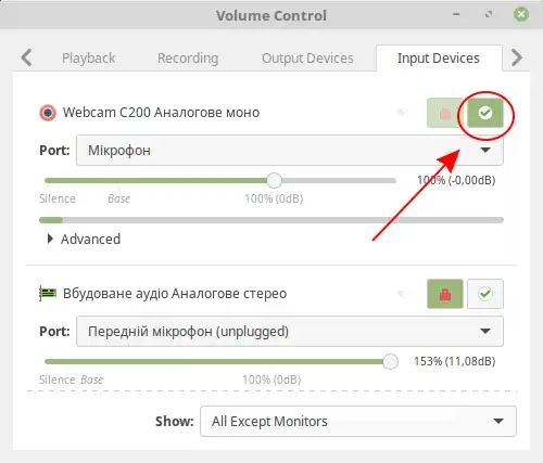

In case when this problem is not connected with the volume level, your system is probably using the wrong input device. I'm using Mint 18 and to solve my problem I installed "pavucontrol" from software center. enter image description here
You will find it is you sound applications - "PulseAudio Volume Control". enter image description here
Go to "Input Devices". There you will see all your mics (real and virtual). You should choose the real one. In my case it's a webcam's mic. Make it default by pressing the green button like on the picture.
That's all. Try log out if not working at once.

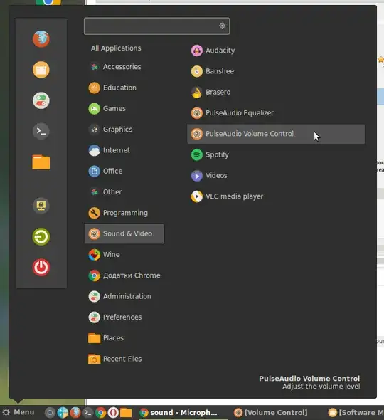

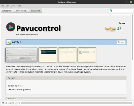

If you already have installed by default PulseAudio, the only thing you should do is to :
  • open Synaptic Package Manager and install pavucontrol.
After that, you will have in Skype > Options > Sound Devices :
  • new button called Open PulseAudio VolumeControl
Click on it and do some additional setting, while (during the Skype - Make a test call) is running!!!

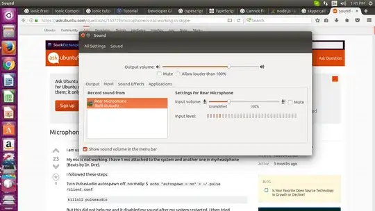

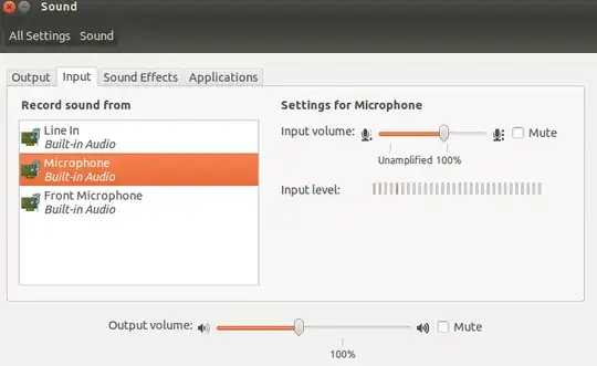

In ubuntu 16.04 just goto system settings->Sound->input, then increase the input valume in it. solution for skype voice problems
