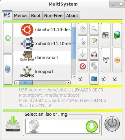

The best software to create a bootable USB from a .iso file for me is multisystem which can be downloaded by clicking this link.
interface
