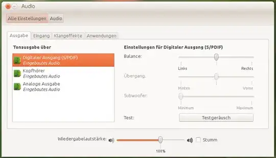

In Sound Settings I can choose between analogue and digital output. When I choose "Digital Output (S/PDIF)" I have to decrease the volume every time after I boot up. What could I do for saving these settings automatically (at shut down)?
These are the settings when I shut down:
And it looks like this after booting:
What becomes saved automatically is whether I chose analogue or digital output, and also the volume settings of analogue output become stored.

When I switch to "Analogue Output" while listening to music, the speakers connected to the digital output can be used, too, but then the volume is by 100% and I can't adjust it - only when I switch back to "Digital Output" or if I use alsamixer and dim "PCM".
When I choose "Digital Output" in Audio Settings and start alsamixer, changing the "Master" volume doesn't have any impact. "S/PDIF" and "S/PDIF D" are shown there, too, but both are set to "00" and I can't modify them ...
When I adjust the volume to a normal level (i.e. 40%) and run sudo alsactl store and reboot, the volume icon in the panel doesn't show 100%, but the sound comes with 100% - until I scroll down above the icon: Then it jumps immediately to 39%.
