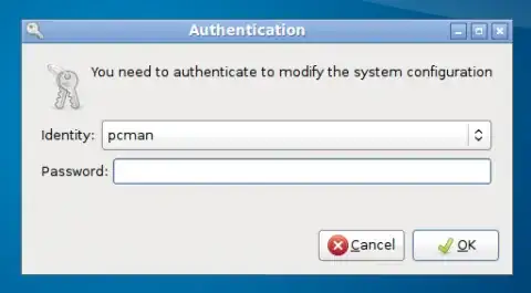

LXPolkit screenshot

In the absence of a policy kit interface, the user is normally asked for a password in the command line. Since this is a menu item, this is launched in the background and there is no command line to enter the password. Hence, you need to make sure you are using lxpolkit. Or if you prefer the gnome polkit, install the package policykit-1-gnome which launches the login menu whenever pkexec is used. I have removed the package policykit-1-gnome and using lxpolkit works well for all applications.
