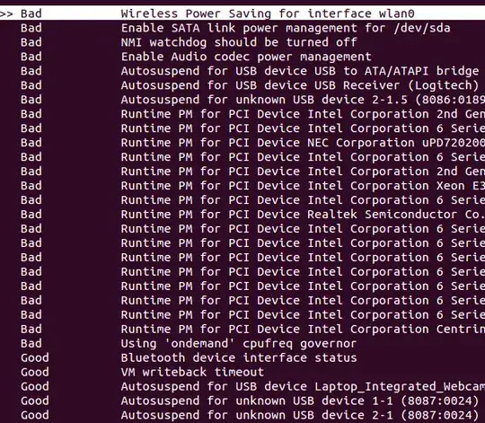

I installed PowerTOP 1.97 and i got many Bad in Tunables, I know i can press enter to toggle but does it really change anything? and if it does will it still be changed when i reboot? If i get everything to show Good will it make a big difference on the battery life?

The Good/Bad settings may or may not help, it really depends on the hardware. Some settings are marginal, others save a fraction of a Watt, others may actually not help at all. Here is some analysis I did late 2011. I used a high precision digital multi-meter and an Atom 450 "HPMini 210-1000" and a Sandy Bridge "Lenovo ThinkPad 220i" machine to sanity check all the powertop settings for the candidate machines.

Note that powertop tries to figure out the power consumed from the battery ACPI status. Some batteries are not that accurate since they sometimes re-calibrate their capacity settings. So one can get some wild fluctuations in battery readings. With the kind of settings you are looking at powertop may not be able to measure the savings because we could be talking about a few mW in savings on each setting.
