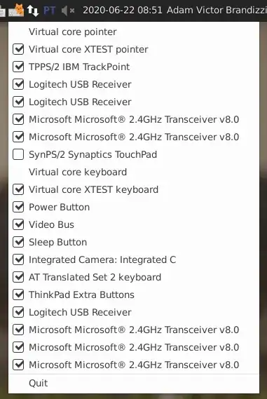

Input device indicator allows you to enable and/or disable your devices from a menu. It uses xinput internally, but you do not need to open the terminal, list manually, type the command etc.
A menu listing devices that can be disabled or enabled.
It is in a PPA, so you can install it with
sudo apt-key adv --keyserver hkp://keyserver.ubuntu.com:80 --recv 03BBACDA765F39D9A14EEDE4425F3F9343B40373
sudo add-apt-repository ppa:brandizzi/ppa
sudo apt install input-device-indicator
To invoke it you just need to execute input-device-indicator (which can be added to the session startup programs) or look for "Input Device Indicator" through the HUD (or whatever it is called these days.)
brandizzi
  • 1,594
