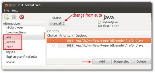

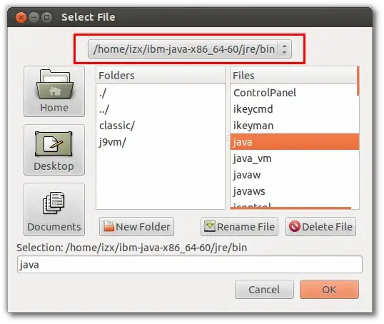

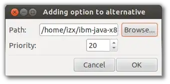

As a graphical alternative to @AnwarShah's command-line method, consider using Gnome Alternatives (sudo apt-get install galternatives):
  • Start GAlternatives, select each java option, change it to manual, and Add your alternative (the example here is the IBM JRE installed in my home directory):
