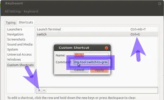

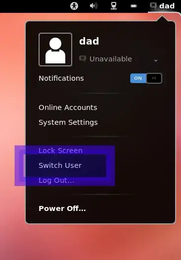

What you are after is available as an extension at https://extensions.gnome.org
Called the Alternative Status Menu - this gives you the switch-user capability.
However - if you really want a keyboard shortcut then search for keyboard and add a new short cut with either gdmflexiserver in 11.10 or dm-tool switch-to-greeter as the command together with the keyboard shortcut itself:
This is described further in this Q&A: - How can I invoke a user switch from the command line?
