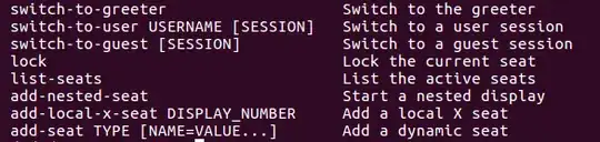

gdmflexiserver as a legacy option to provide the greeter switcher service during the transition between GDM and LightDM.
This has now been dropped from 12.04.
The replacement command is:
dm-tool switch-to-greeter
Other useful dm-tool options (dm-tool --help):
