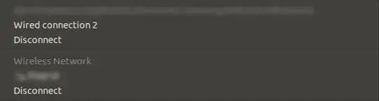

If I have a wireless and a usb internet connection on my Ubuntu 12.04 as in:
At the moment, Ubuntu seems to only make use of the Wired connection which is the usb connection. Is it possible to get ubuntu to use the wireless connection without unplugging the wired connection?
So basically, as will, I would like to switch between the connections without unplugging any of them while leaving them both enabled.
Is this possible?
