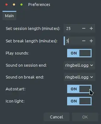

Atareao's pomodoro-indicator
Having tried others, I recommend Atareao's Pomodoro Indicator App.
Why? It is simple, beautiful, configurable, has been tested in ubuntu 14.04, 14.10, 15.04, 16.04. It has a PPA and the developer is known for writing quality indicator apps such as my-weather-indicator.
My favourite thing is that the icon changes to reflect how much time is left. Here's a time-lapse screen capture I made:
Time lapse of Pomodoro Indicator
This is what the preferences look like (polar night gtk theme):
Preferences window
Installation: Copy and paste the following in the terminal:
sudo add-apt-repository ppa:atareao/atareao
sudo apt-get update
sudo apt-get install pomodoro-indicator
