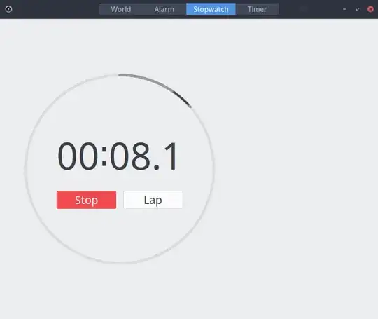

Gnome Clocks is good and installs easily through the Ubuntu software manager, at least on 18.04, or from the command line through sudo apt install gnome-clocks. It has fairly few dependencies (at least no Gnome Shell required).
It has a stopwatch and a timer, plus world clocks and alarms:
screenshot
https://help.gnome.org/users/gnome-clocks/stable/
The online stopwatch and timer is good and easy but seems to take significant cpu in chrome. Gnome Clocks is very low on cpu overhead.
