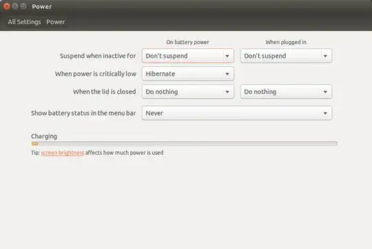

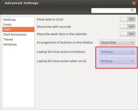

Here are the two common Gnome 3 ways which usually disable suspend; otherwise you can try booting with the acpi=off parameter:
  1. Power Settings:
  2. gnome-tweak-tool (install if necessary):

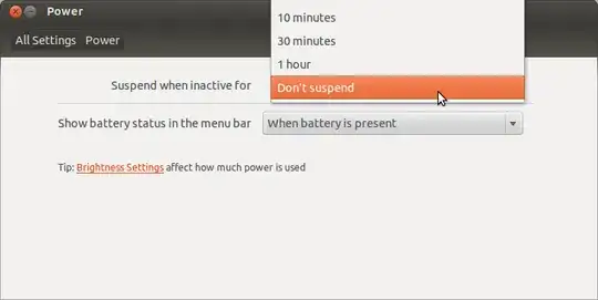

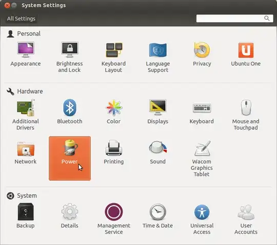

From System Settings or by searching in Dash, go to Power settings. You'll find what you need there ;)
Power settings

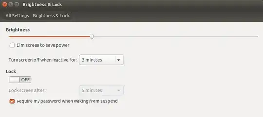

And to prevent from locking, go to Brightness and Lock:
Brightness and Lock settings

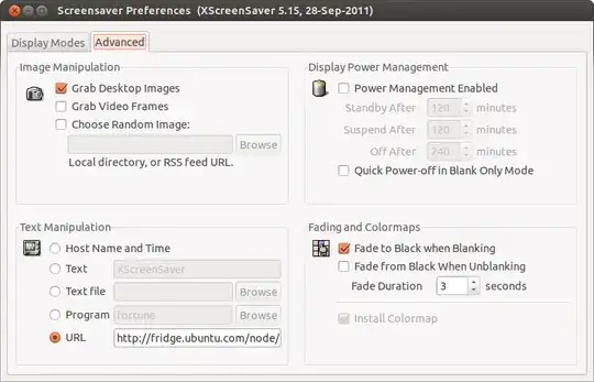

In unity dash type screen saver, and click on it. When the window open click on the advanced tab, and uncheck Power Management Enabled.
