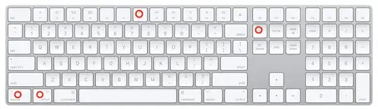

Some Apple Keyboards require holding the Fn key to complete Ctrl+Alt+F7 sequence because the top keys have different assignments by default. Apple keyboard
