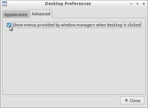

  2. On the desktop, right click and select Desktop Preferences, click Advanced in the new opened window and tick Show menus provided by window managers when desktop is clicked.
    desktop preferences

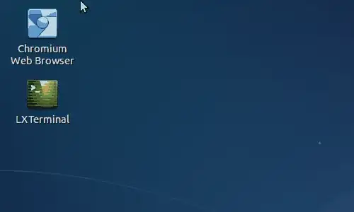

The result, as I tested in Lubuntu 13.04: (Make sure that you logout, and log back in for changes to take effect).
refresh desktop in lubuntu
(Sorry for the low quality of the animated gif, but I just don't have time to find something better for the moment)
