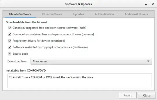

Both packages are in the Ubuntu universe repository. Enable this repository in Software & Updates as per screen-shot below.
After that
sudo apt-get update
sudo apt-get install nautilus-refresh
