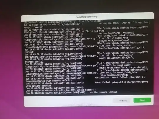

I have a problem while installing Ubuntu 24.04 version on my SSD. I crashes multible times without a clear reason. I installed it before without a problem. I took an image to help anyone to understand the problem. I also tried to unblug the internet cable (as someone here suggested who has the same as my problem)
Crashing While installing at the final steps

According to your logs, the program cannot mount /dev/sdc1, which is, if I understand well, tne partition of your SSD disk (/dev/sdc) that must be use to host your future / Ubuntu partition. Possible explanations:
  • Some binaries of the Ubuntu installer are broken. You could:
    • Check the md5 sum of the ISO you downloaded. See Easy way to Verify Ubuntu ISO?
    • Try another installation support (another DVD/USB stick/...) as you might face a hardware issue.
  • The target filesystem is broken, because the underlying hard drive has hardware issue. See How can I check the health of my hard drive?
