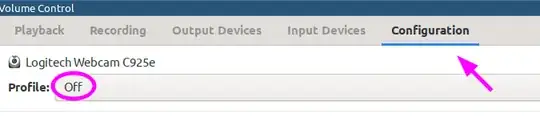

Just set the soundcard's profile to "off", for example:
pactl set-card-profile alsa_card.usb-Generic_ThinkPad_Dock_USB_Audio-00 off
pavucontrol can do this is well in its "Configuration" tab:
An alternative is to completely disable any auto connect functionality in pulseaudio, however I like this functionality in the case of my bluetooth headset. With the above solution you can disable soundcards in a fine-grained manner.
