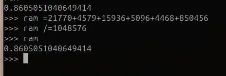

I would say this is probably natural. Some quick addition of the figures in the first line of the kernel boot messages shows 0.9Gb. If you have 1Gb allocated to integrated graphics then there is your 1.9Gb
