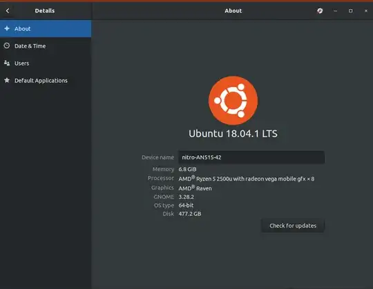

I have Ubuntu 18.04 dual booted with Windows 10. Windows 10 shows full 8 GB RAM.
But in Ubuntu it shows only 6.8 GB.
"About" screenshot
Is there any way to make it near 8 GB or is this natural?

This line:
[    0.000000] Memory: 6929972K/7238032K available (12300K kernel code, 2472K rwdata, 4248K rodata, 2408K init, 2416K bss, 308060K reserved, 0K cma-reserved)
indicates that BIOS is giving the kernel 7238032K of memory. The rest of the memory is being used by the BIOS:
8,388,608 K Total - 7,238,032 K Kernel = 1,150,576 K reserved by BIOS.
That is an unusually large amount for BIOS to reserve. You would have to look at your BIOS settings to perhaps try to figure out why.
Doug Smythies
  • 16,146
From: Why my acer nitro 5 (AN515-42, Radeon RX 560X) 8gb ram but its just 6.9gb ram usable?
This can only be "fixed" in the bios! But not all bios allow you to change the pre-allocated memory of the video card, because there is a risk of the notebook turning a brick! Can you take a picture of this setting?
Ubuntu is using your CPU's integrated graphics, which consumes ~1.1GB of system memory, whereas Windows is using the discrete graphics, which consumes no system memory.
I'm not sure why Ubuntu defaults to the iGPU, but you can possibly get it to use the dGPU by ensuring that your AMD GPU driver is up to date. If that does not work, you can try using the hybrid graphics feature to switch between GPUs, but do note that this feature is very experimental and very low-level and could easily prevent your Ubuntu install from booting if your hardware setup isn't correctly supported.
