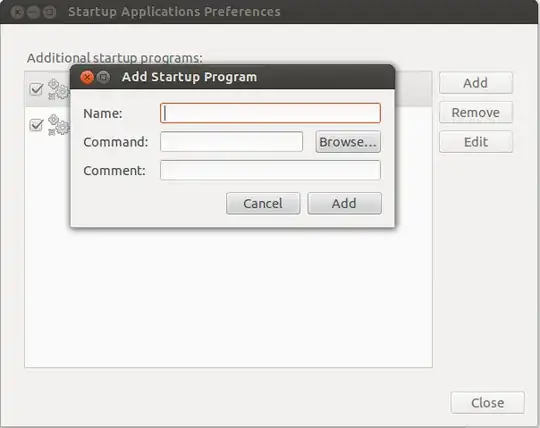

Well, I had exactly the same problem; I also followed the link you gave and it didn't solve it for me! The thing is, that I did that 3 days ago and I don't quite remember the whole process very well. Sorry for this...
These are the steps I did and solved the problem (NOTE THAT the fact that it worked for me doesn't mean that it will work for you!):
  1. Run this from the terminal (to open the terminal hit Ctrl+Alt+T):
32 bit
wget -O ~/dropbox.tar.gz "https://www.dropbox.com/download?plat=lnx.x86"
64 bit
wget -O ~/dropbox.tar.gz "https://www.dropbox.com/download?plat=lnx.x86_64"
  1. Open nautilus to your home directory and untar the dropbox.tar.gz file
  2. A hidden directory (.dropbox-dist) will be created. Click on the icon, right from your username on the upper right corner of your screen, and then click on startup applications. Click on add: add
  3. In the 'Name' field add 'Dropbox', and in the 'Command' field click on 'Browse...', then head to your home directory, give Ctrl+H to reveal hidden files, click on dropbox-dist and then select the file dropboxd. In the 'Comment' field, add whatever you want.
  4. That is the part that I don't remember very well...Open a terminal and give
    cd ~/.dropbox-dist;./dropboxd
It will ask you for your account info as usual, I think, or it will say that dropbox isn't installed (and it will say to run dropbox -i start). Do whatever necessary (sorry :( i don't remember what I did) so as to fill your account info and such and to login into your dropbox account!
  1. After all this, check if dropbox is running (open system monitor), and if it is, then stop it (kill it or whatever :D). Install hamster-indicator and set it to start on system startup.
  2. Restart your computer!
  3. Now you should have the dropbox running and a working indicator of it! You can now uninstall hamster-indicator (I told you to install it so as to have a working indicator, that's how I fixed mine!)
Sorry if this don't work for you....
