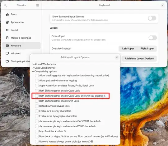

There is a workaround suggested by Janne Snabb (which requires Tweaks: sudo apt install gnome-tweaks) and confirmed by two other users that I'm quoting below (with some formatting added by me):
This workaround has saved my sanity:
  1. Go to GNOME Tweaks → KeyboardAdditional Layout OptionsCompatibility options
  2. Enable Both shifts together enable Caps Lock; one Shift key disables it
Here is a screenshot of the relevant option:
Screenshot showing the option mentioned above
