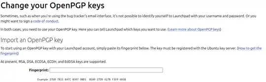

from popup at: https://launchpad.net/~militiaofgeorgia/+editpgpkeys (Learn more about OpenPGP keys)
Generating your key in Ubuntu
The easiest way to generate a new OpenPGP key in Ubuntu is to use the Passwords and Encryption Keys tool. If you are using Ubuntu 10.04 or an earlier version, it is located at Applications > Accessories > Passwords and Encryption Keys. In Ubuntu 10.10 and later versions, it is located at System > Preferences > Passwords and Encryption Keys.
Step 1 open Passwords and Encryption Keys.
Step 2 Select File > New, select PGP Key and then follow the on-screen instructions.
Now you'll see your new key listed in the Passwords and Encryption Keys tool.

Generate / Publish / Import to Launchpad
It sounds like you want to sign the Ubuntu Code of Conduct and it's requiring you to import your GPG key. There are many tutorials on AskUbuntu as well as the internet. Here's a summary:

Import GPG key to Launchpad account
Next, import your key to Launchpad. This requires the fingerprint, which can be gathered as follows:
$ gpg --fingerprint
gpg: checking the trustdb
gpg: marginals needed: 3  completes needed: 1  trust model: pgp
gpg: depth: 0  valid:   1  signed:   0  trust: 0-, 0q, 0n, 0m, 0f, 1u
gpg: next trustdb check due at 2027-03-29
/home/mike/.gnupg/pubring.kbx
pub   ed25519 2025-03-29 [SC] [expires: 2027-03-29]
      C171 EB28 F0FE 3AE0 D8B3  B3BA 3582 ED26 FB81 BDF8
uid           [ultimate] John Smith <johnsmith@example.com>
sub   cv25519 2025-03-29 [E] [expires: 2027-03-29]
In this example, the fingerprint is C171 EB28 F0FE 3AE0 D8B3 B3BA 3582 ED26 FB81 BDF8. You want to copy/paste your key's fingerprint into the fingerprint box on your profile page for your Launchpad account.
