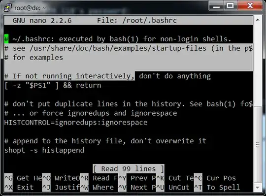

I can select all file by going to the 1st line Alt+\, start marking the text by Alt+A, go to the last line by Alt+/
But there, I don't know which key to remove the selected text. Hit delete doesn't work for me but Ctrl+K to cut the text will destroy my clipboard.
So, what is the hotkey to delete selected text?

nano of course can delete blocks, see this article
  1. use CTRL+Shift+6 to mark the beginning of your block
  2. move cursor with arrow keys to end of your block, the text will be highlighted.
  3. use CTRL+K to cut/delete block.
To paste the block to another place, move cursor to the position and the use CTRL+U. You can paste the block as often as you want to.

To delete multiple block without overriding your clipboard, first mark the text with Alt+A (You will appear Mark Set then select the text using arrow keys) and then use Ctrl+Shift+K to delete selected text,deleted text won't appear in clipboard.
nano >= 3.2
This adds support for the Alt+Del keyboard shortcut, which deletes text without Cutting it.
nano >= 5.0
You can delete the selected text by piping it through a command with no output: using Ctrl+T, and running | true (or |: if you really want to cut down on keystrokes)
